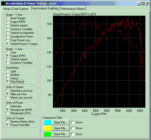

I have a helix downpipe, bosal catback, perrin ic hoses, sti scoop+gr-spec splitter and was running the 3/16ths mod during test.
Maximum Wheel Power: 188.8 BHP @ 5941 RPM
Maximum Wheel Torque: 187.2 LbFt @ 4121 RPM
Power to weight ratio: 121.8 BHP per ton
Terminal velocity due to power: 157.0 mph
In Gear Acceleration:
30 - 50mph = 2.6 seconds
40 - 60mph = 2.6 seconds
Speed per 1000 RPM:
1st: 5.6 mph
2nd: 10.0 mph
3rd: 14.2 mph
4th: 19.9 mph
5th: 26.3 mph
Maximum Speed per Gear:
1st: 39.8 mph
2nd: 70.7 mph
3rd: 100.7 mph
4th: 141.5 mph
5th: 186.4 mph
Total Vehicle Mass: 1550kg
Drag Co-efficient: 0.37
Frontal Area: 2.20 square metres
Wheel/Tyre Setup: 235/40/18
Engine Rev Limit: 7100
Test gear: 2
Max Speed of gear: 71 mph
Air Intake Temp: -36 °C
Atmospheric Pressure: 0.25 bar
