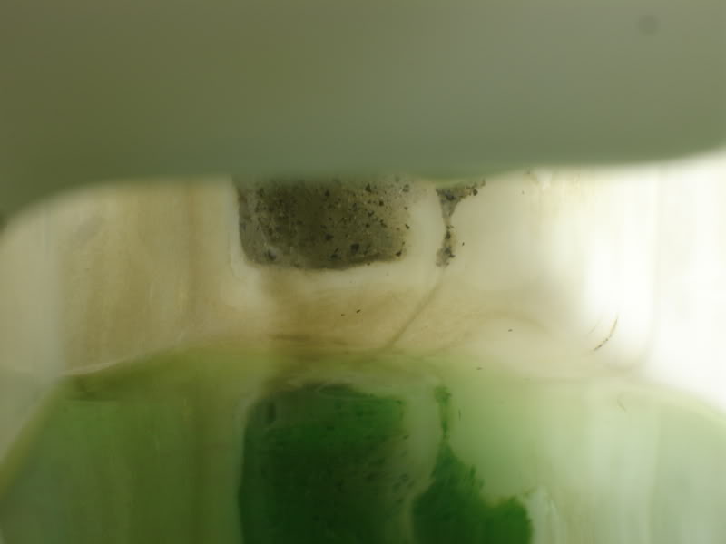

Here what I did on saturday...
Spark Plugs
Standing in front of the car...
Driver Front
Driver Back
Passenger Front
Passenger Back
Throttle Body
Inside of intercooler Y pipe
Inside of turbo
This side (turbo side) was real dirty, I'm guessing blow by
Water reservior
And to my surprise when I was taking off the first plug I found a big *** hole on what I'm guessing to be the timing belt cover.

Everything seems normal (except the hole). I'm still getting white smoke. I changed the oil from Royal Purple 5w-10 to Mobile 1 10w-20.
Where can I get my oil analyzed?

What is that sediment in your coolant resevior, it looks like sand??
