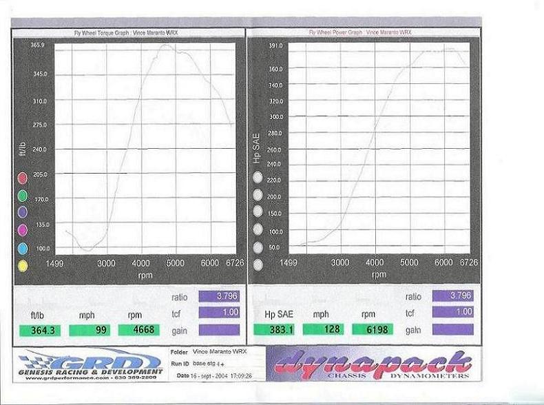

you might want to add nitro to the list as well as you will never see 11 sec e.t in the quarter with a vf 34. i will bet my car on it,and i have 383 awhp and 364 tq. and i cant hit 11's the best power you will see is 290awhp with a vf34. here is my dyno plot.i am not trying to bash.
Attached Thumbnails What kind of turbo? HELP want to be in the 11's-dyno-plot.jpg

i agree, at best the vf34 with a link standalone will give you 300 whp, to get in the 11s i think a fpgreen is in need
