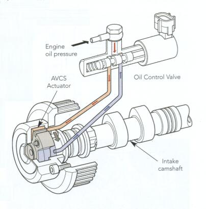

won't the STi come with AVCS when it comes out here? but then i heard that it may/may not come on the car because it would make the car too strong and fast i think it would help reduce emmisions

From what I have heard, it is very good for drivabilty but not so good for high performance modded WRX's.

Cam phasing is very overated. Especially on FI cars.

I might be wrong, but doesn't a nice turbo pretty much negate the need for variable valve timing? I remember Honda first developed VTEC as some kinda turbo alternative or something, right? I'm not too sure on either count though, hehe, so someone please enlighten me.

Cam phasing is there simply to reduce the compromises made in cam selection. But a wild cam for a phased system will have idle problems the same as it would on a standard type system. Cam phasing is all about being able to use wilder cams maximizing the power band and still idling well. On FI cars though, the difference is small because FI cars require less aggressive cams. On FI cars too much overlap equals boost lost out the exhaust valve. So the difference in the actual cam grind standard vs phased will not be much on an FI car. Pick your grind properly, and your set either way.
The Porsche system though, oohhha. Modifys lift and timing. That you could really justify.

the sti wrx has that feature. We will see more of this on most of the Subaru lines to meet EPA's ever rising standard.

Very helpful, scooby5! Makes good sense; variable valve timing is like frosting on the cake kinda. Thanks.
