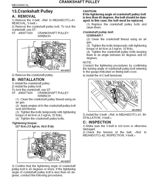

Wasups guys... was wondering how to install the Perrin Crank pulley... anyone know?

Try this. Hopefully you can read it.

I would remove the radiator just to avoid damaging it.

easy. there are instructions that come with the pulley.
if you are doing it solo, block both sides of the front tires and put it in 5th gear. this will let you break the bolt free by yourself.
remove the altenatior cover (10mm)
if you have a person helping you, have them stomp on the brakes.
don't pry on the pulley to take it off.
maybe use some penentrant to free it up.
as a last resort, you might have to tap it with a rubber mallet.
