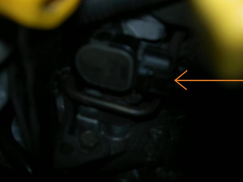

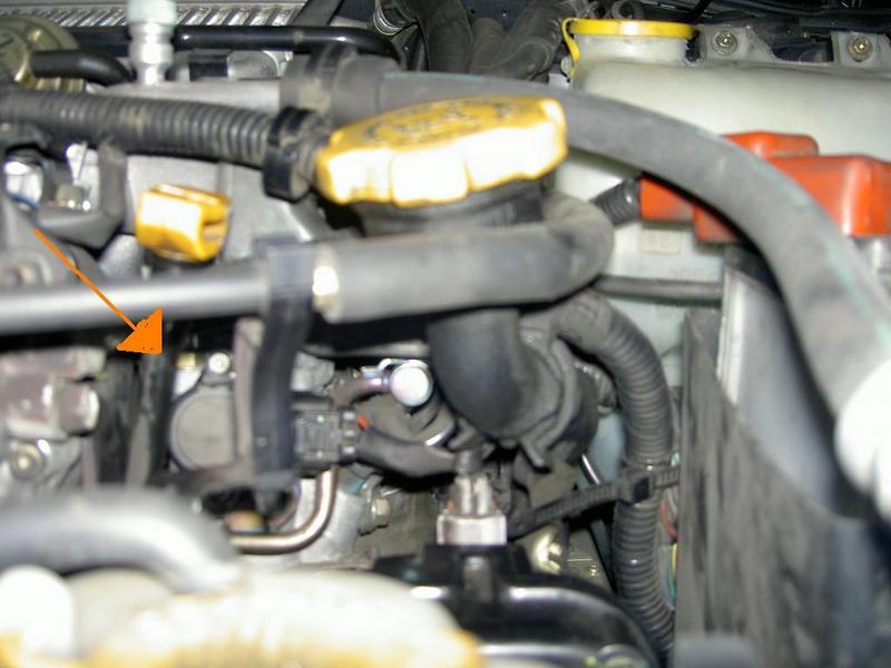

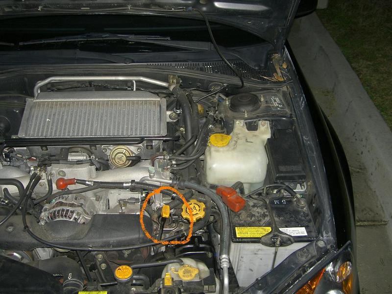

Also I found what I am pretty sure is the part online at Autozone, follow this link for a picture
http://www.autozone.com/R,APP264208/...ductDetail.htm
attached are pic's of the TGV and it's location on my car. If anyone know's weather or not Subaru is F.O.S. or not please let me know. Or if the Code P1068 is something other than what I descrbed above, any help would be greatly appreciated.

figured it out!
Never mind about the above question, I figured it out. The valve can be replaced, but when you put it on the part where the wiring harness hooks to needs to be pointing up. rotate 90 degrees clockwise, (to prime the spring) and screw in. Subaru dealer is F.O.S. !!!
