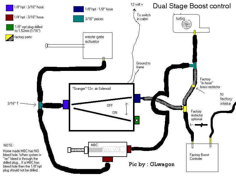

This pick isn't exactly what you have, but... There are 2 restrictor & the necessary one is in the hose & before the "T"... The second one is optional & usually gets upsized to a 3/16" coupler.
If you start at the light grey hoses; Then, get rid of the dark black ones, mbc & the solenoid. That is the factory setup...sorta
The key indicates "factory parts" you can see the order of things & how it was sorta...
If this gets you totally lost then ignore it.
