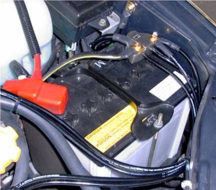

I did this mod myself.
I honestly thought there was some improvement.
San

Grounding Mod Complete.
Thank you to all the fine people on I-Club who have given me the knowledge and insight on how to do the grounding mod
After reading many different way's on how to do this mod i've decided to do it this way:
For $50 dollars i made my own kit using:
1) 1 gold plated battery terminal with 2 top mounted 5/16 bolts for attaching ring connectors.from auto zone.
2) 18' of 8 gauge wire only used about 14' from sounddomain.com
3) 3' of 4 gauge wire.sounddomain.com
4) 12 gold plated 5/16 ring connectors for 8 gauge wire.sound domain.
5) 2' shrink tubing. from local harware store.
I used 5 grounding points ommiting the strut towers because i felt the rubber bushings made for a bad ground. I will however in the future add the 2 strut grounds to see if there is a difference.
5 grounding points i used are: All 8 gauge wire.
1) DS fender next to battery.
2) PS fender next to air box.
3) DS intake manifold.
4) PS intake manifold.
5) Firewall behind the intercooler.
What i did differently is replace the stock 8 gauge battery wire that grounds to the MGP (main grounding point) located underneath the intercooler on the engine block, with 4 gauge wire. Also replacing the stock 8 gauge DS fender ground with 8 gauge wire and gold connectors i made from my kit.
Results:
a) no difference starting in cold weather.
b) no differnence at idle.
c) lights slightly brigher.
d) noticable difference through-out RPM range...much smoother.
