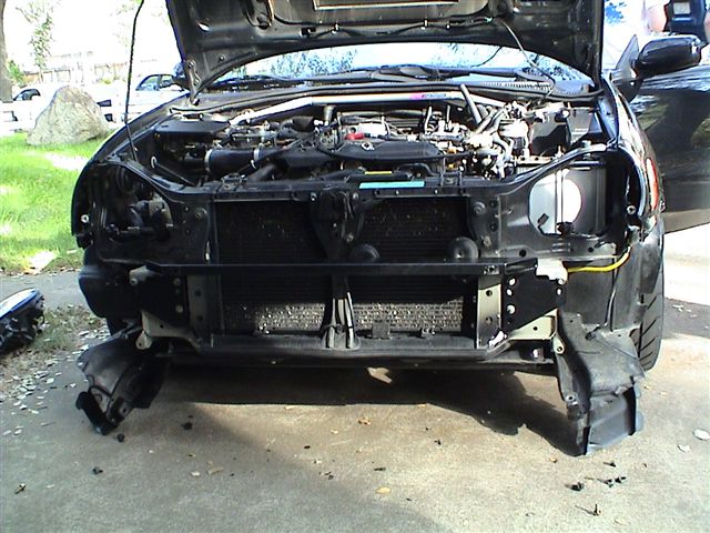

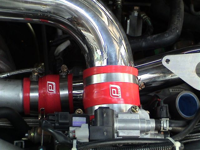

Perrin FMIC -
Great fit on the 04. Good fit on the 02 with some major bumper trim, but it works.
If you're making a sleeper and you want a fmic it may be better to go with a black one which I think APS makes, but you can always throw a grill in front of any of the fmic's to kinda hide it a bit and protect it from rocks, re-tread, birds, etc.
Install is pretty long. You have to remove the plastic bumper and the bumper beam and the headlights and fogs if you have them. There is some plastic fender liner on the drivers side of the 02 that needs to be cut in order to pass some piping through it. Install will take 6 to 8 hrs if you have all the right tools and you're doing it yourself.
Pros:
Kit includes everything you need.
Fits very nice.
Large bling 3" piping
Can use stock BOV
Large IC core
Great for track use (does what a FMIC is designed to do).
Great flow and cooling performance for high HP cars.

Here are some photos of mine:
Attached Thumbnails Front mount intercoolers?-dsc00118-1.jpg   Front mount intercoolers?-dsc00130-1.jpg   Front mount intercoolers?-dsc00132-1.jpg

more photos:
Attached Thumbnails Front mount intercoolers?-dsc00133-1.jpg   Front mount intercoolers?-dsc00135-1.jpg   Front mount intercoolers?-dsc00136-1.jpg
