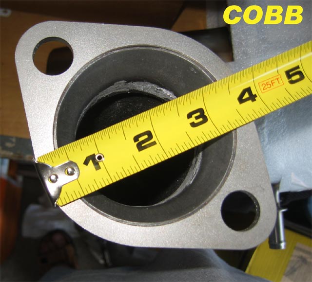

I was able to get a picture of the Cobb flange. Take a look at the attachment. Since you have seen both Helix and the Borla flange, did the Borla Flange look anything like the Cobb in the attached picture?
Thanks!
Thanks!

-I'm not sure where you live, but in California, any modifications to the Catalytic converters (like switching them for high-flow aftermarket ones) are illegal.
-As for the Helix Downpipe mating properly to a Cobb Catback, yes it will w/o modifications. We have installed for customers a Cobb Catback mated to a Helix Up & Downpipe combo w/ no problems at all. Feel free to PM or shoot me an E-mail at soren@mpjperformance.com if you have any more questions.
