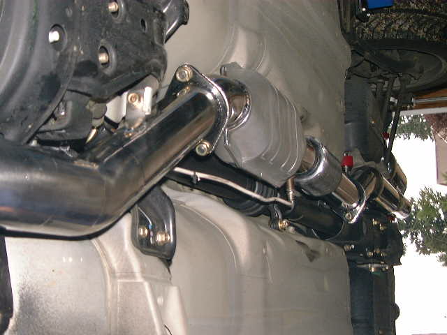

I was thinkin up pipe, downpipe, and cat back (but there will be no cat due to up pipe? ) or turbo back, but is there a Carbon Ti turboback? They cost so much too . . . . .well does HKS make a a good up and down pipe?
The factory up-pipe contains one catalytic converter, of a total of three in the WRX exhaust system.

if u get a catless downpipe doesnt it remove 2 cats?
Yes, I was only referring to the up-pipe. Replacing up-pipe and downpipe will remove two cats. Check out this nice exhaust diagram.
