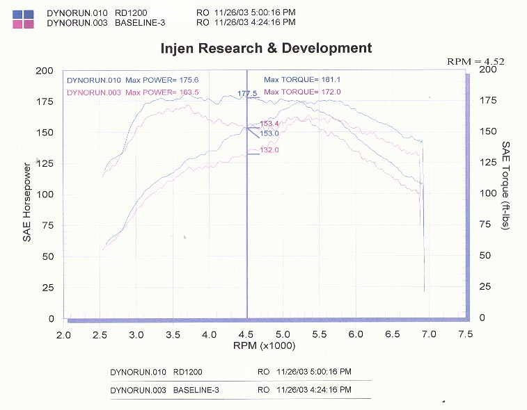

What about this dyno chart?

Origami posted by rexmaster
"Injen Research & Development" is not an independent test lab. Chart doesn't even state what type of vehicle was being tested, nor which dynamometer was being used for testing. Injen sells intakes - what do you expect their dyno charts to say?
There's no af ratio.
