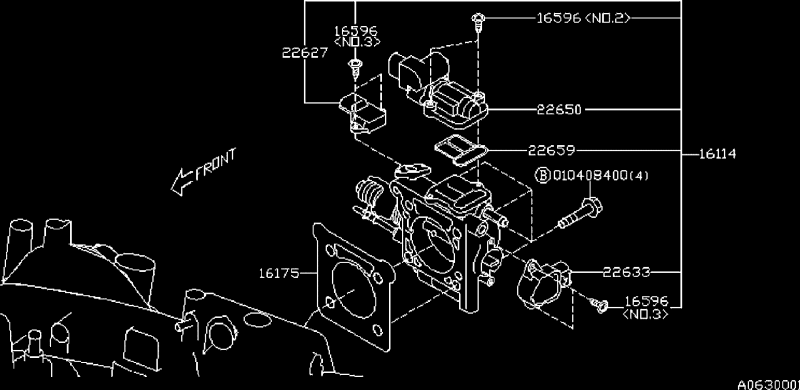

I had different CEL, but same problem. It ended up being the Idle Control Valve on top of the throttle body. Expensive part ~ $300, but fixed the problem and CEL immediately. I got mine from Mastro Subaru (http://mastrowrx.com) Some people have had luck cleaning theirs, but that didn't work for me. Part 22650 in the attachment.
