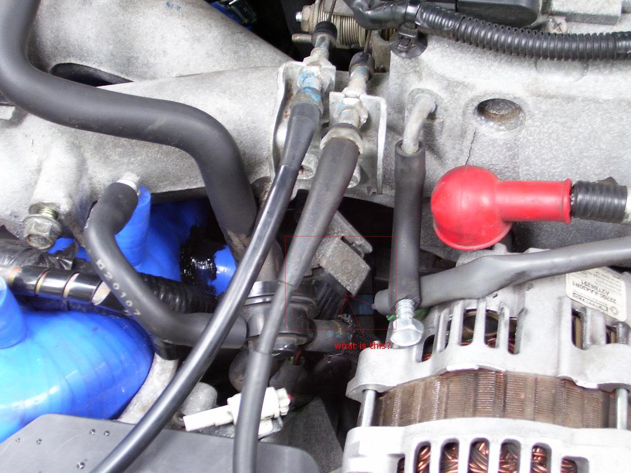

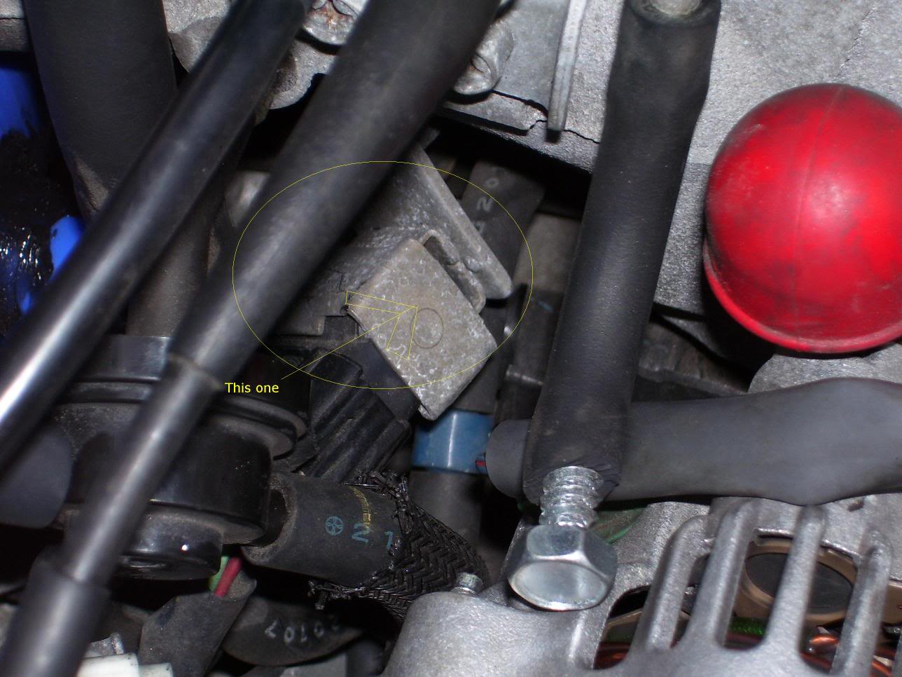

I installed a turbo inlet this past week, and in the process of taking out the stock inlet, I managed to rip the bottom out of some sensor. The sensor had vaccum running through it and leaking vaacum. I plugged the vaacum line and drove it for a bit before getting a CEL with a DTC of p0457 (evap leak) I want to know the name of this sensor so i can get a new one. here are some pics.

for noob searching purposes. the sensor has been identified as the Purge control solenoid valve.
