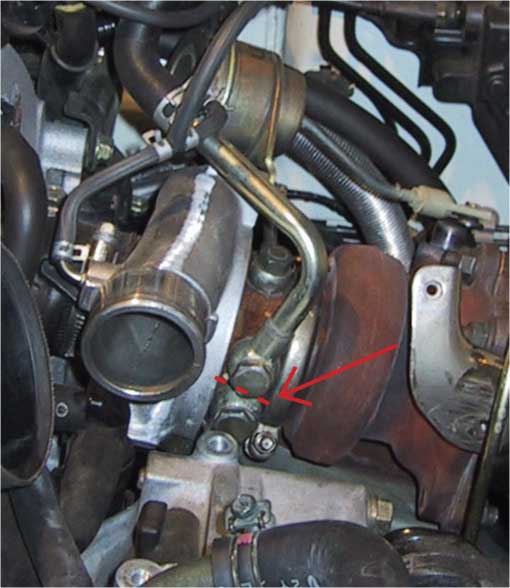

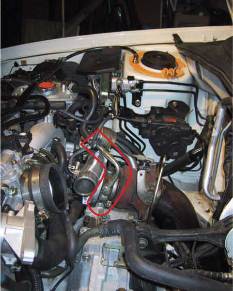

Okay, I have no clue. I did break something upon installation but I don't think it could be the cause of my problem. Please correct me if I'm wrong. The bronze metal pipe that bolts onto the side of the turbo (see pictures below) snapped in 2 but between the 2 bolts. Upon inspection it appears that no lines were harmed. It doesnt look hollow.
I could be wrong though. There may be a reason that this was cast as one piece. Any ideas?

It was a clean break along the dotted line.

That tube is a coolant or oil line to/from the turbo. I would check to make sure that the uppipe is sealed and is not leaking same with the DP. If the uppipe is leaking then that could explain why you are not achieving full boost except when under WOT.
Also if there is a vaccum hose that you forgot to connect that could also explain why you are not hitting full boost except for under WOT. Quite a bit of boost could be bleeding off because of this. I am more confident in this because engine vaccum is higher than normal and and would explain the boost issue.
Are these pictures before or after it broke?

After.
