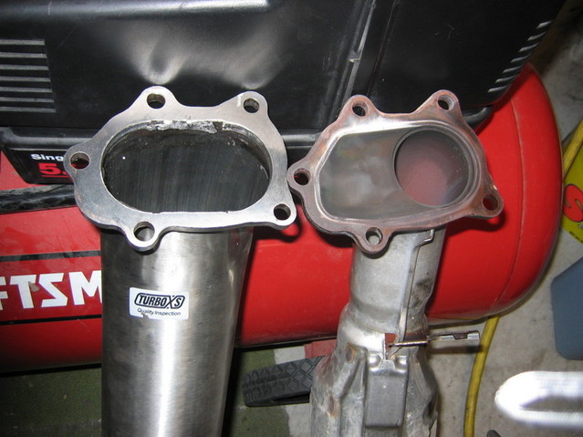

Here are some better pic's of the TXS (not mine) to give you a better idea of how it looks. The thing I like about the DP is that the bellmouth tapers to 3" smoother than any other DP I've seen (no abrupt turns). Will that make a big difference? Probable not but IMO it is the best design out there but then again I'm no expert on exhaust flow. If you have the extra $ I'd suggest the TXS but if not most DP's like the Helix which IMO is the best DP for the $ will work great.
BTW, the upipe in the pic is an STI which I also have on my car and I'm very happy with it. Click on pic's for a better view.
good luck
Attached Thumbnails best downpipe to use-txs-dp.jpg   best downpipe to use-txs-dp-2.jpg

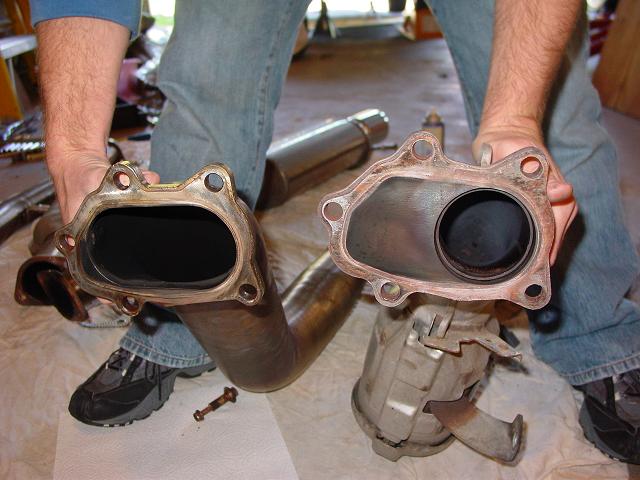

another good pic.
