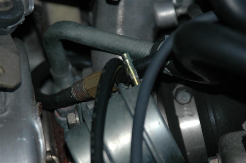

Well, I finally popped my hood and look what I found.....
Looks like it has been disconnected for a long time also (possibly from when I bought the car 3-4 months ago.
