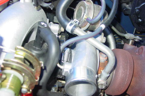

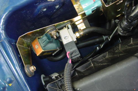

Originally posted by Irok_1_wrx
is this the right place to hook up a avcr to wrx the one of the gold piece is to com the other it to on
BTW, that is right. The wastegate (gold piece) goes to the COM, and the turbo inlet goes to the NO.
Also, make sure you reconnect the factory boost solenoid. Make a loop with vac hose from one side to the other, and plug it in. If yoiu don't you will get a CEL.
