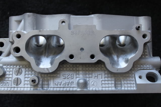

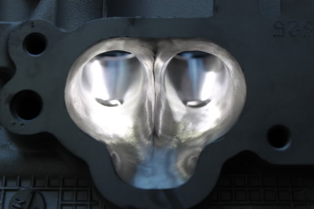

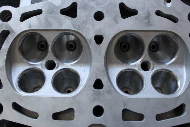

Customer: Nick Bullion's EJ25 "B25" STi cylinder heads. Ported and polished by yours truly.
