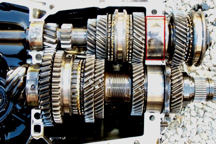

After spliting the tranny case, it was pretty easy to determine the cause of death. All of the bearings sounded a little rough, but the rear ball bearing on the input shaft was really bad. A lot of spalling on the race and *****. The bearing also wobbled quite a bit on the shaft.
All of the gears looked fine, including the ring & pinion. Syncros & baulk rings are in great shape, even with the many missed shifts I've subjected them to over the last 218K miles.
Overall, I'm pretty impressed by how well this tranny held up. Yes, I understand the EJ22 is no power house, but I also don't try to spin all four wheels while bouncing off the rev limiter.

Bearing outlined in red is the culprit; lots of spalling on race & *****.

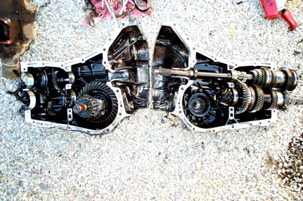

Case split apart.
