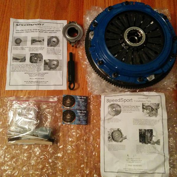

The clutch arrived on May 20th, about a month and a half wait. It was 1200 from MVP Motorsports. This is the lightened steel flywheel clutch, there is also an aluminum FW option. I installed the clutch on Saturday, May 24th at 68180 miles and need to do a 500 mile break-in. It has a slightly firmer pedal feel like any new HD clutch cover probably will have. Initial driving impression is it seems to feel like a stock clutch engagement wise with a little more firm pedal. No shudder or jerk on take off and seems to slip fine not on-off like a puck clutch.
