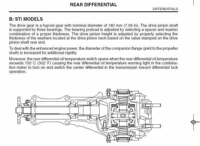

Sounds like you can drive it as long as the fluid level is ok. take a look at this.....

Thanks for the info. I phoned the service department today, he told me not to drive the car. It will be towed to service this Sunday. He thinks that a seal may have failed and the differential is low on fluid.
