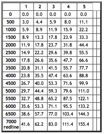

I think it lowers the top speed by ~10-15 mph. You won't be able to reach the top speed anyways unless you're illegally speeding on 101 between San Jo and Gilroy, other than that in a 1/4 mile race or on teh track you probably wont reach the top speed
RA Gearset is at roughly 156mph at 7000RPM
Stock gearset is at roughly 168mph at 7000RPM
these are calculations, not actual tests, and I may not have found the correct ratio for the stock 5th gear

well calculated its higher than 130, I don't feel like actually testing it though.
seriously though, when do you go over 130? 65mph by the way is around 3150rpm (right when the turbo starts to spool )

http://www.car-videos.net/tools/spee...B1=Recalculate
if you're seriously looking into RA gears let me know and you can come down to Monterey and check mine out. No top speed testing, but you can see how the gearing is in daily driving
