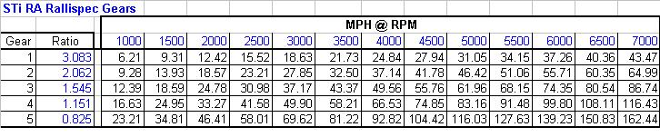

For anyone considering a gearset/tranny swap, I have created a spreadsheet in Excel of the most common WRX gearsets (gimmie, kaaz, RA, etc.) that shows you MPH in each gear at 500 rpm intervals. There's also a section to calculate RPM at a given MPH (say you want to know what the RPM's will be with the RA gearset at 80 mph in 5th gear).
All you have to enter is your tire sizes and final drive ratio. You can also play around with the gear ratios on the last table which includes room for 6 gears.
If anyone wants this, send me an email.
RA Gearset based on 225/40/18 tires and 3.9 final drive:

For quick calculations yourself:
RPM = (MPH x GEAR RATIO X FINAL DRIVE X 336) / TIRE DIAMETER (in inches)
MPH = (RPM X TIRE DIAMETER (in inches) ) / (GEAR RATIO X FINAL DRIVE X 336)
Tire Diameter (in inches) = (((Width (mm) X Aspect/100 ) X 2) / 25.4) +wheel diameter)
ie: Tire Diameter for 225/40/18 = (225*.4*2)/25.4 + 18 = 25.087"
