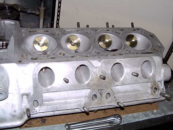

People mistakenly assume that hemispherical combustion chambers are an American invention and only apply to big V8s. That is simply false. Many European manufacturers used hemispherical combustion chambers as early as the 1930s.
In my opinion, they work best in dual overhead cam engines. Their strength is that a properly designed hemispherical combustion chamber is that it flows very well.
Their weakness, and the reason they are not used more commonly used today, is they do not promote as much "swirl" or air/fuel mixing as a pent-roof combustion chamber, and this is necessary for clean emissions.
Alfa Romeo 4 cyl DOHC "Hemi" head

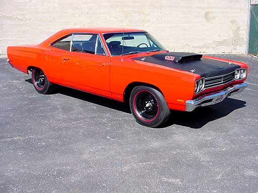

While the Hemi cars were pretty awesome, and certainly one of the fastest street racers around, there was one slightly hotter MOPAR option:
The 1969.5 440 Six Pack A12 "M-Code" Super Bees and Roadrunners These cars were lighter than the Hemi cars, with a lift-off fiberglass hood and virtually no options, just a 4-speed and a Dana 60 rear. They were only built for 6 months.
Don't get me wrong, I love the 'Hemi cars, especially the 'Cuda, but my money would always be on the M-code car.

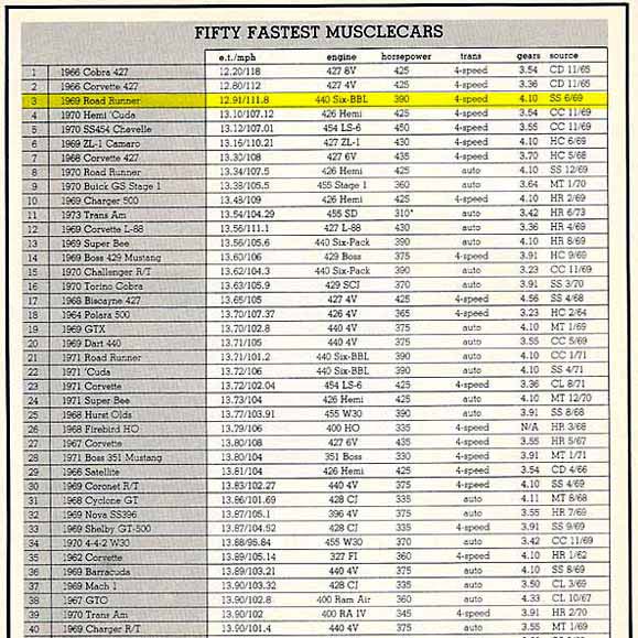

For your perusal:
