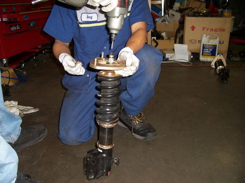

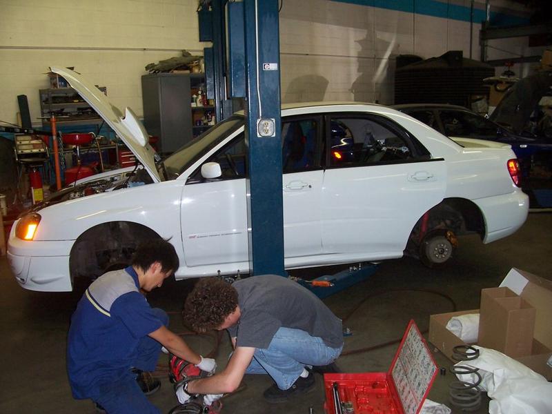

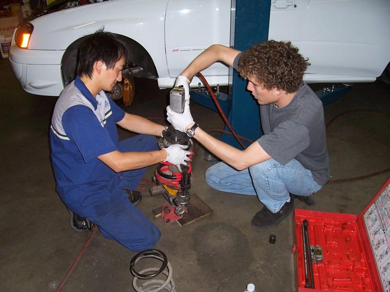

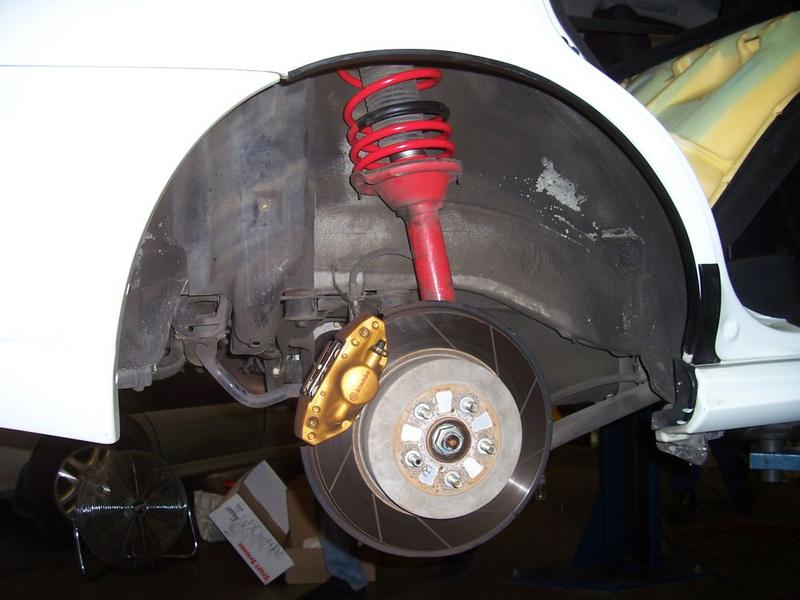

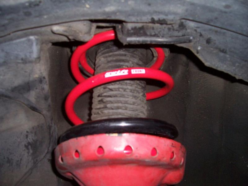

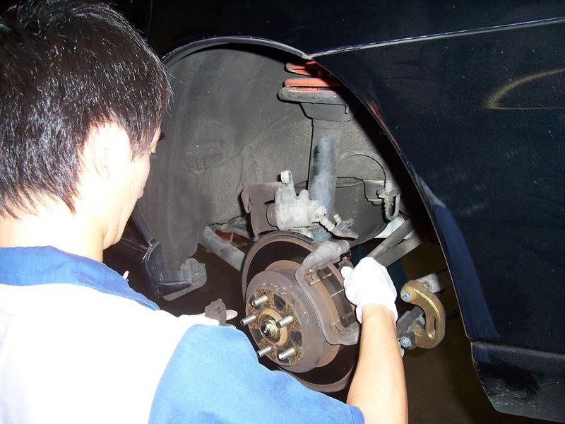

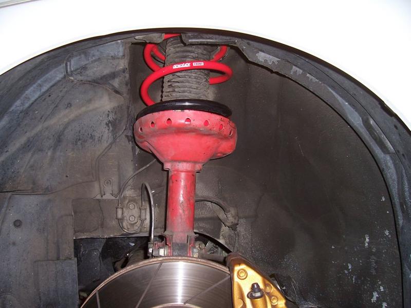

Today@AutoHQ (09/05/08):
--Swift spring install on a 2004 STI
--Remove & replace rotors and brake pads on a 2005 WRX
-New brakes - so shiny!

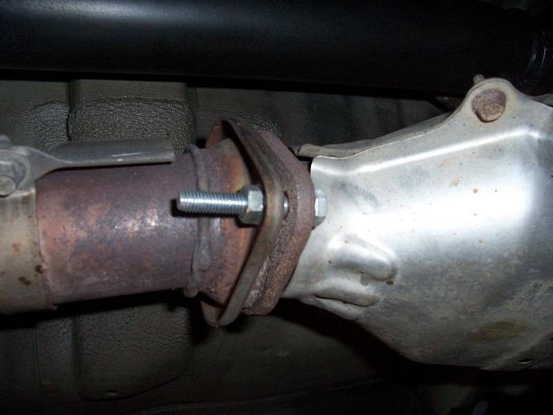

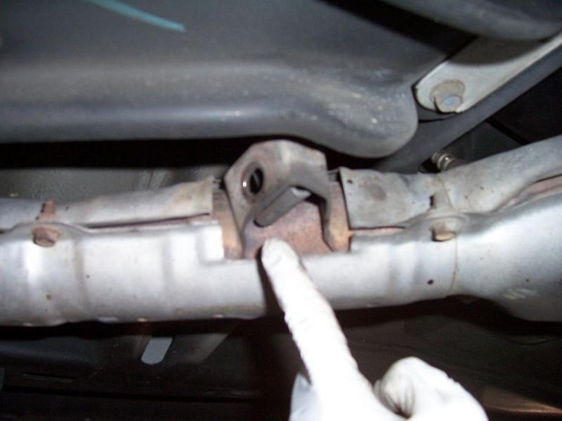

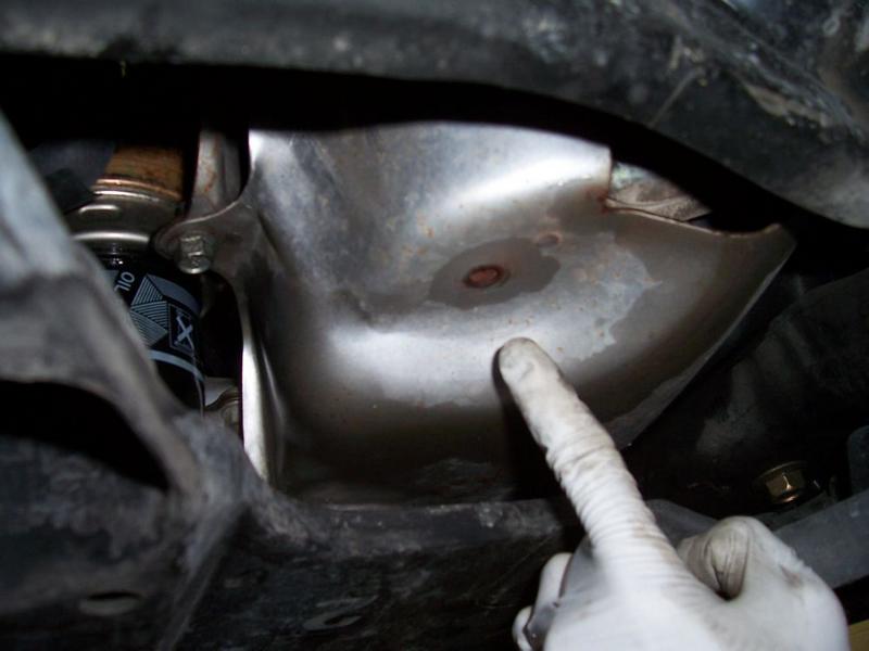

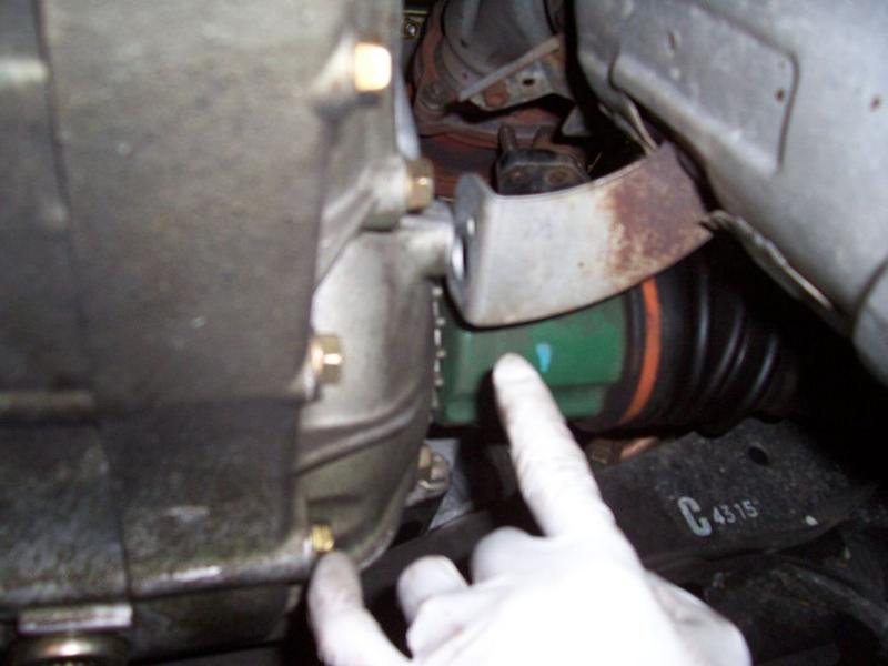

--Last few pics:
-What not to do on your car:
-Missing bolts
-Not using the correct oem spring bolts on d/p to cat back
flange... NO, NO, and NO!!!

Today@AutoHQ (09/05/08) Continued:
-one more no no pic!
-note: the flange is all bent and warped..

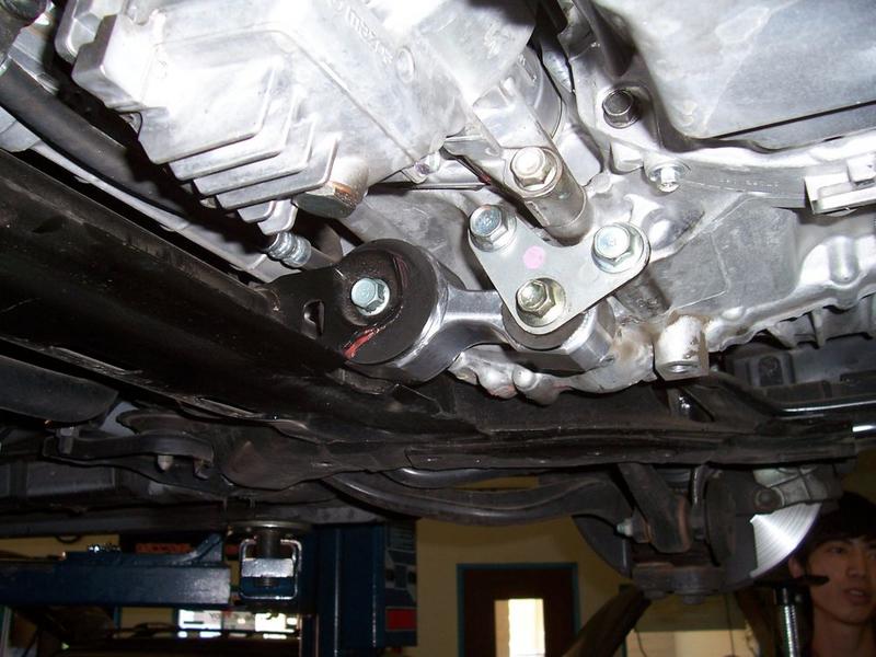

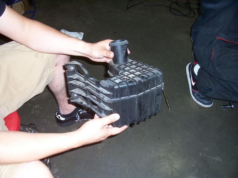

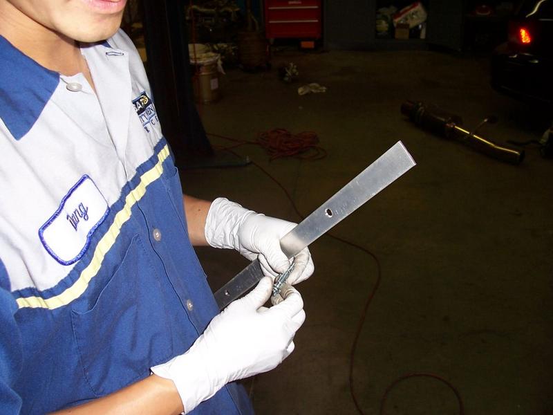

Saturday@AutoHQ (09/06/08):
-30K major service performed on a 2004 WRX Wagon
-Performance parts installed on a 2007 Mazdaspeed 6
-Test Pipe
-Engine "Dog-Bone"
-Eibach Springs

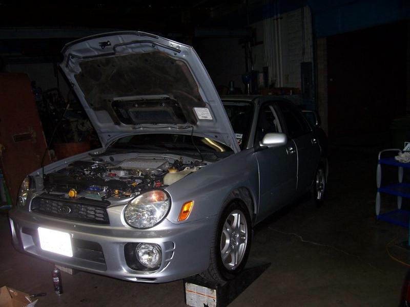

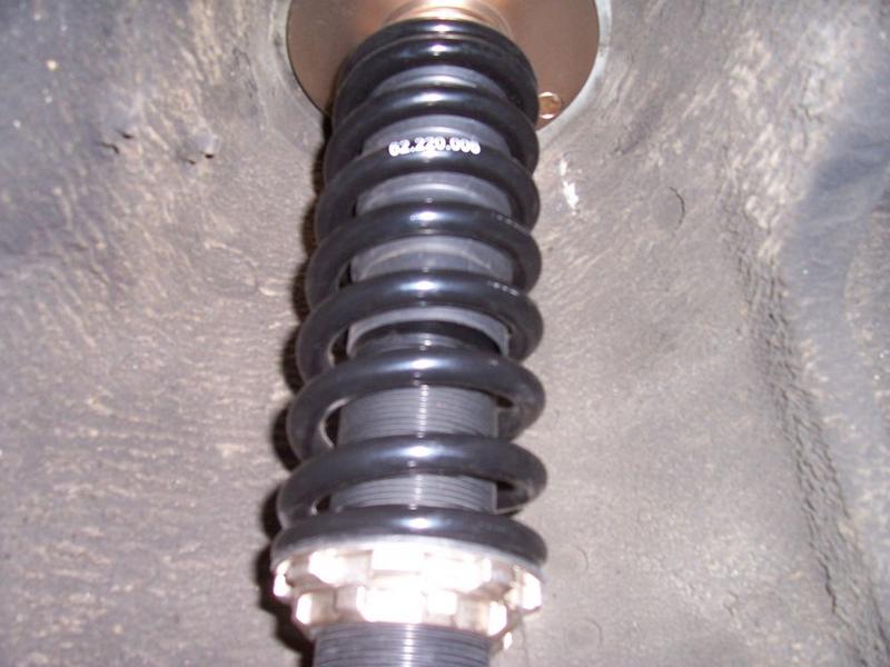

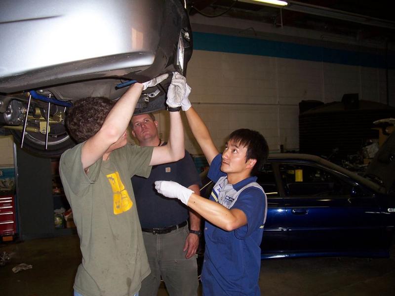

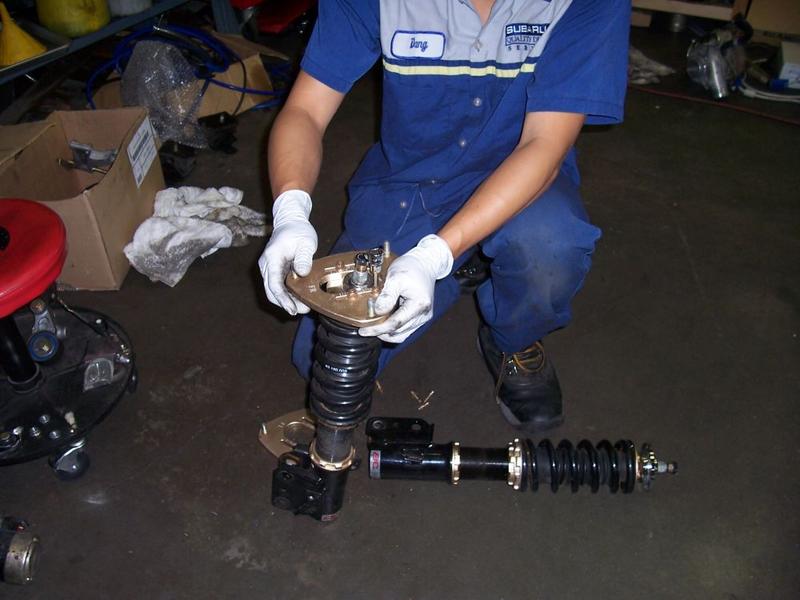

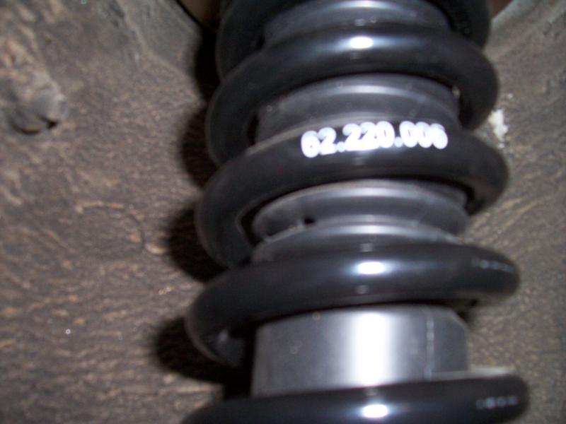

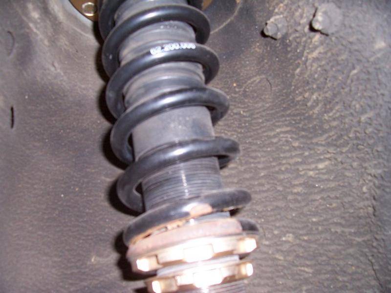

Today@AutoHQ (09/09/08):
-fender rolling rear fenders of a 2002 WRX Wagon
-repaired botched job of coil over installation of same car above
-rear coil over springs mismatched: left rear 220mm & right rear 200mm -Wtf!?!
-rear camber bolts not even tightened
-rear lower shock mounts loose
-all fixed
