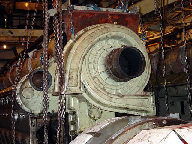

You don't have hair one if you don't run this turbo!

god how fun would it be to throw a truckfull of dead babys into that.
