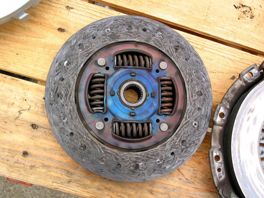

This thing was done! Was getting into the metal of the resessed Allen screws holding the discs in place.
