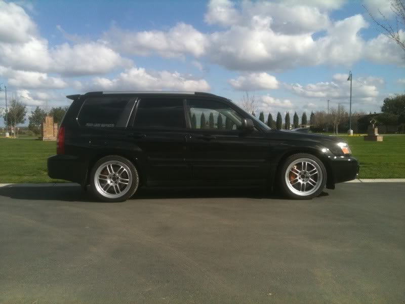

Originally Posted by wrxBRAH
Nice the 50 sidewalls definitely suite your Fozzy better and it looks like the JDM Pinks ride considerably lower than the prodrives
Yeah, the 235/50s are pretty fat. Keep in mind, I'm running the Prodrives with 1" spacers for extra height. Without the spacers they'd be probably within 1/2" of the JDM Pinks in the front, but the pink rears are at least an inch lower than the Prodrives. As far as rates, JDM Pinks are 257/217, USDM STi springs are 224/194, Prodrive reds are around 235/194 (supposedly measured rates, Prodrive doesn't disclose real rates. They are also progressive, so rates may be higher once you compress them some).
Picture above is with '04 STi-fitment Ohlin fps, Prodrive red springs and Jackson Rally 1" strut spacers. I'm also running the Whiteline roll adjustment kit.
