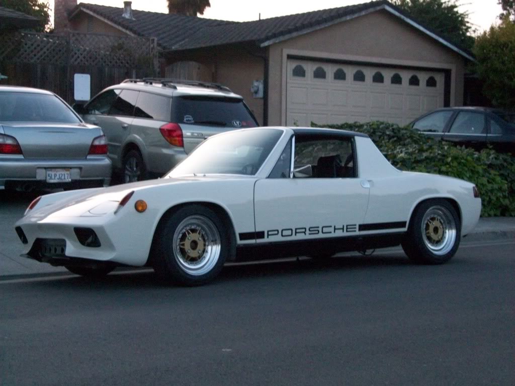

First i got the wheels finished, balanced, and mounted on the car....
And second.... It's now legal to drive on the road. Insured and updated registration!
Now I just need to actually finish it....haha, here comes another five years.

Damn, nice job so far. What all do you have to finish?

interior, gonna do new front wheel bearings tuesday after work, front sway bar, drop the motor to paint the engine compartment, pull the gas tank and repaint the front and rear trunks, build the foglights, and add hella supertones...
Not much...lol

You gonna keep the front seats or get something more bucket? lol

^^ for now just run the stockers. I bought all new covers for them so I'll run em... But id like a sport seat that has a tad more bolstering, but still looks like a stock seat.

clean car. Classic Porsche model

Ive always loved Porsches, but I know there are people out there that will say "That's not a real Porsche", does that **** **** you off or do you just ignore them?
What is the stock motor HP output? Is it possible to put a motor from a 996 Turbo, or just 996 N/A into it? Now THAT would be sick.
My only gripe about the car is that it has poor safety ratings, but thats nothing a cage can't fix!!! The car looks very clean man, VERY clean. Probably one of the best 914's I've ever seen, so GOOD work on taking such good care of her.
All you need is a motor swap and no one, and I mean NO ONE will be able to touch you! That light of a car with that much HP... HAHHAHAH! Talk about a FUN car. Don't forget the cage if you plan on upgrading the motor though.

I always tell people that say its a VW " It's actually a Porsche/VW/Karman-Ghia.... so you know nothing" and that usually shuts them up quick.
The block started off as a stock 2.0L with about 92-95HP. That got stripped down, kept the same crank, but put 96MM pistons and jugs on it and had the heads brought to euro spec and bigger valves. Now it'll make around 120.
But it is possible to put the bigger H6's in the car without any modification to the chassis of the car. You have to remember that even the h4's were built with all the sutff yu need to put a H6 in them front the factory, all you need id the H6 motor mount and oil tank. You can even do an sti sewap or a vette motor. it's all about chassis stiffening and braking at that point.
Thanks for the comments everyone. I'm gonna bring it out on wednsday to zen, but I got to go to work.
