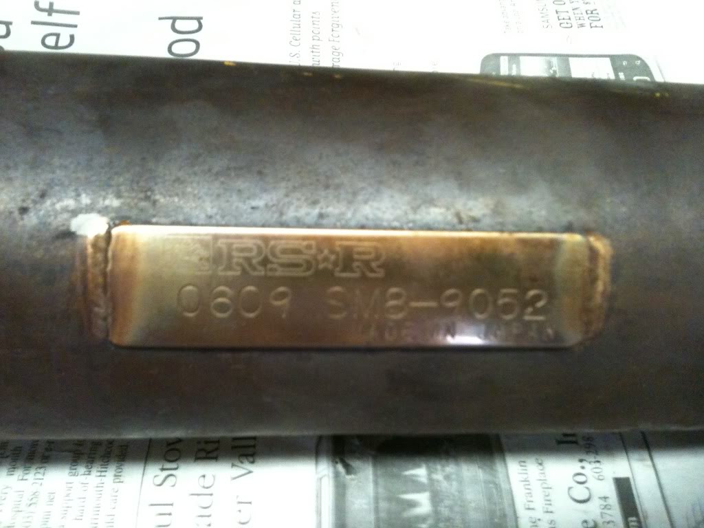

From left to right. wrx catless (full downpipe replacement), wrx catless top section only, usdm wrx, jdm wrx.
If thats your situation, then you got a JDM length downpipe. Also I believe jdm downpipe only has 1 bung for o2 sensor.
If you really really want to use that downpipe, here is a suggestion:
Production part by RS*R: Name:  IMG_0532.jpg
Thats for JDM downpipe to USDM midpipe (catback).
Or just have an exhaust shop fabricate one to your fitting.
