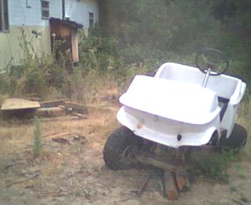

I think I'm gonna build this thing up. Maybe a SR20DET or something....yeah or something. We'll race.
http://www.craigslist.org/eby/zip/46160390.html

You put an engine in that thing powering the rear wheels.........
it'll flip as soon as the starter kicks over.
