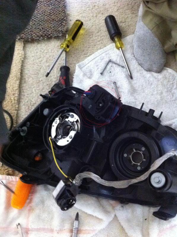

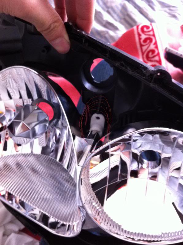

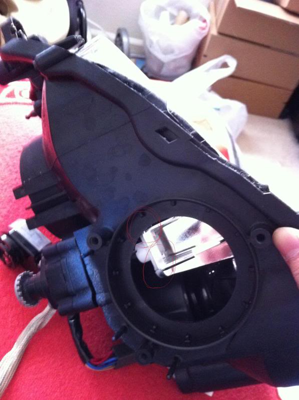

I am in the process of doing a tsx retrofit on my 05 sti. I am having issues with removing the reflector from the housing. The leveler /motor thing has a rod coming out from the back into the housing and has 2 screws held in. For the life of me, i cannot get those screws off because of the angle and position.
If anyone has any experience with removing the reflector on a sti headlight, please shed me some light! Give me a text at 510 366 6892 for a quicker response! Thanks everyone!
Here is the two screws that holds the rod onto the reflector.

Old Mar 21, 2011 | 05:49 PM
04 WRX Subie's Avatar
Posts: 191
From: bay area
nvm pryed it out!
Old Mar 21, 2011 | 09:50 PM
RU-X's Avatar
Posts: 3,904
From: SF CA
Car Info: 05 wrx
yups, pops right off. watch out for the black bit that attaches to the leveling screws, that little black thing falls out.
