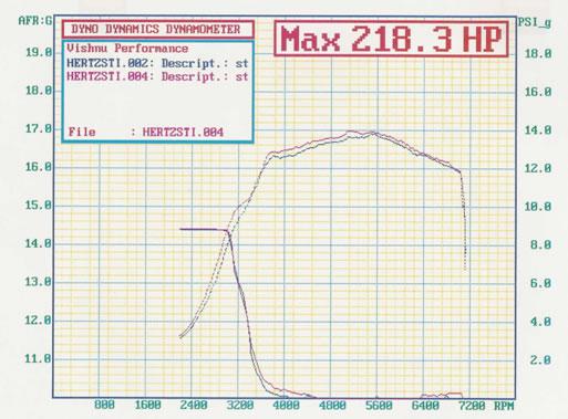

BTW heres the STi dyno from Vishnus site, My STi did the exact thing A/F on ATPs dyno, dumps right between 2700-3200 right off the chart. First thought was it was pinging and dumping fuel but Dan Godspeed says our ECU wont add fuel when it pings(unlike the EVO) just pull timing. Does your go rich that quick?

That's typical A/F for an STi. It doesn't add fuel to quell knock, basically because it won't help. It runs super rich from the factory.
