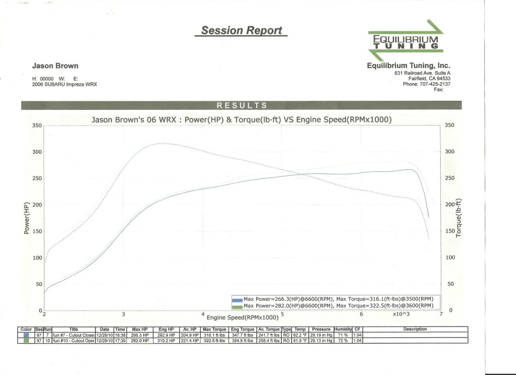

you will have power gains form the cutout. mine is tuned with it closed. if you get it tuned with it open you will see more power gains
got it at Blacktrax in milpitas
