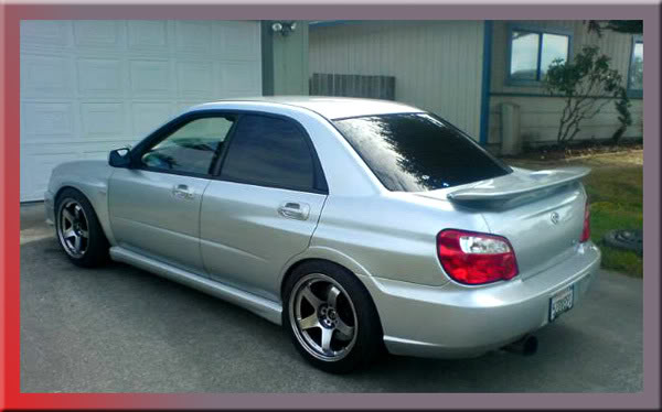

Tease from my phone
Suby Beef!
I have my good friend setup to take pics of it Thursday or Friday and he happens to be a professional photographer so no pics from my 4.0MP Cannon
