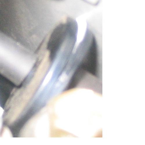

Originally Posted by hYpE-R-29
here is is
any1 wanna explain this to me.....d u guys think this is whats causing me o bestuck at 10psi...The white thing is popping out
You need to figure out if you are only making 10 psi boost, or if it is your gauge that is only reading 10 psi boost. MPJ can probably help you with that, I'm sure they have a test gauge or you could try delta dash and read the ecu.
BOV can cause this problem. A boost leak can cause this problem. A bad sender can cause this problem - I think that fuzzy picture you sent is the sender for your gauge.
If MPJ is not too far away take it over there or since Soren seems to live at Gruppe-s take it over there
Good Luck.

can any1 explain from the pic, if the sender is broken in half?
