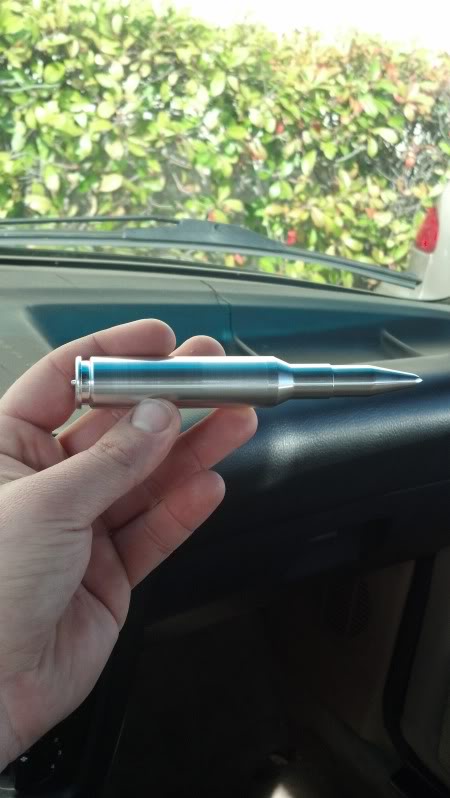

I could only find a drawing with very basic dimentions. Anyone know where to find a more detailed one? Better yet, anyone in sac have a .50 round i can borrow. I guessed on most of the stuff.
Old Mar 2, 2012 | 02:44 PM
  #180
CaliSuby's Avatar
Joined: Sep 2008
Posts: 4,064
From: Watson,Kalifas!
Wow that a HUGE bullet!
