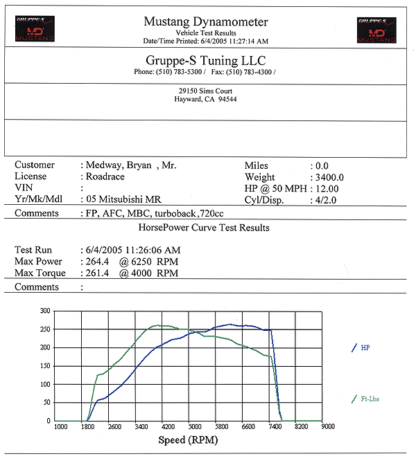

What AFR? Have the AFR chart too? Damn those are nice numbers and a nice curve for only catback and tune.
For comparisons sake, here is my evo on same dyno with more mods. heh:
