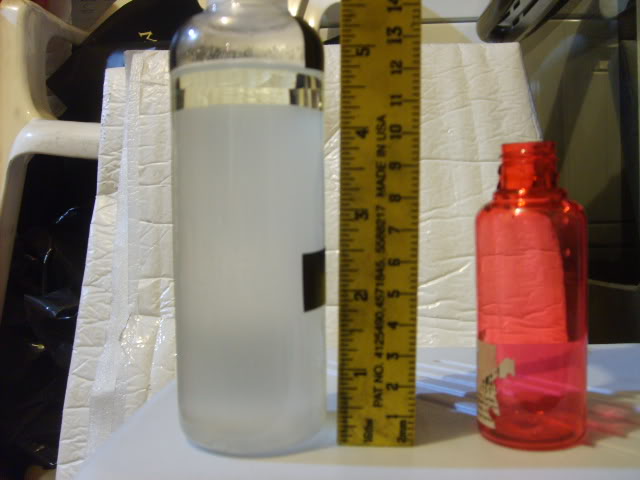

there have been cases in many of the bayarea e85 stations having less than 70% content, so check your e85
atleast in every big fill up
30 minutes wait, about 82-83% content
