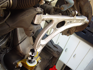

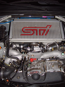

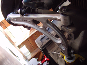

This weekend I FINALLY got a chance to install some things that I have been sitting on for some time now, and everything went soooo smoothly, I could hardly believe it. :banana:
-Ted
STi Lower control arms
Whiteline ALK
JDM V7 STi topmount
-Ted
Whiteline ALK
JDM V7 STi topmount

LOL, seriously! Those buggers tend to jump out infront of you at the most random times...so far from what I can tell, the car handles awesome with the new LCAs and ALK....I havent "really" tested them out on a twisty road...but the few hard corners I have taken really impressed me, a night and day difference....and my poor nephew (he's 11)...LMAO....he wasnt expecting me to corner as hard as I did at first, and I could hear his melon whack the rear pillar, followed by a little "oooohhh".....LOL, he's a great sport, I gotta give him props.

LOL, you bastard.
Yeah, the car does handle better, so it seems. You should remove the subframe. I did cuz mine was bent. Anyways, it feels so much better. Less understeer which is nice in our cars.
You should try some poly steering bushings, as well. Car will feel even better. I'm sure you'll like the brakes too. What's next??

Thats right around where I was before I changed my TMIC but I was running 17psi, now my car is running really rich with the STI TMIC, so I figured instead of getting another reflash, then having to do it again when I get all that other stuff, I will just hold off and do it all at once. Its motivation to go out and buy all the goodies.
