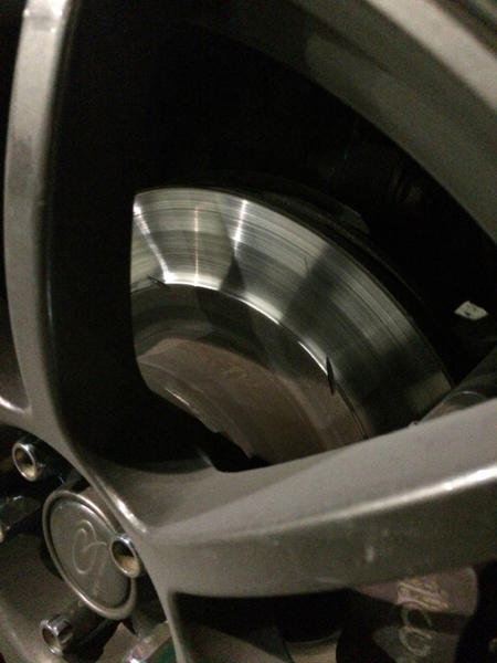

I'm running ht-10 pads so once theyre heated. They're pretty aggressive so I need something that can take the heat and abuse. I think the dba 4000s I have did well. But they're 10 years old with no slots left now lol.
Attached Thumbnails Centric/Stoptech Rotors Clarification?-image-231047442.jpg
T2s or T3s? I'm running T3s right now and they seem fine. They do make the pads dust a LOT though, but you had the 4Ks, so they would have too
