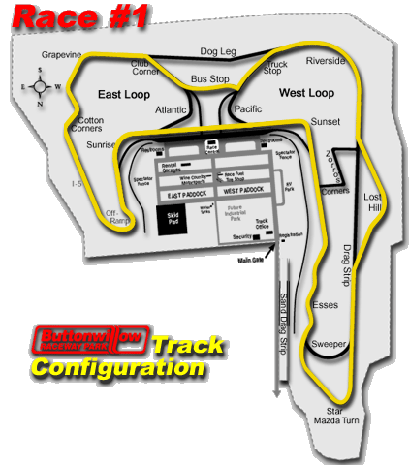

this is the track map.....it actually looks really easy.

Old Nov 17, 2006 | 01:29 PM
Daredevil's Avatar
Posts: 6,715
From: at the track
heh heh heh ^
looks easy, they all LOOK easy
dont' worry about it you're going to have a fantastic time no matter what. unless of course your wreck your car. hehehe
one piece of advice, if you run off the track. just let your car run off the track, do not try to get back on. you'll sling shot once your tires hit pavement again.
