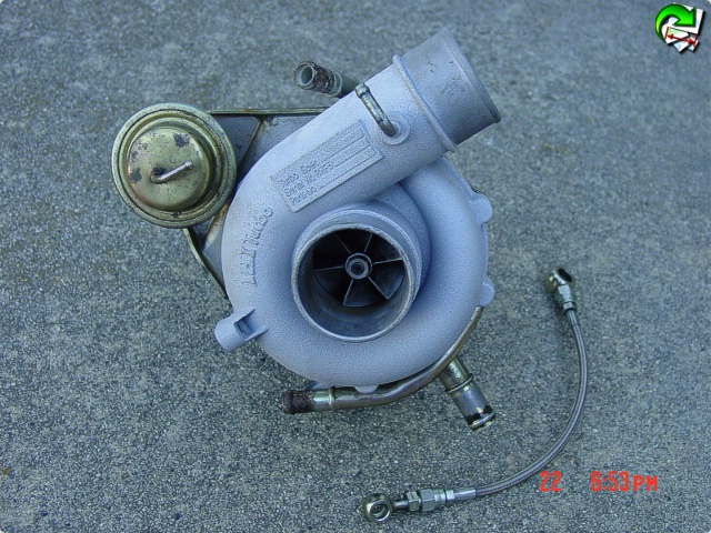

Old May 22, 2004 | 11:46 PM
WRXncrew's Avatar
Posts: 692
Car Info: http://goo.gl/XpkO0b & '99 SF 'S'
Ported & Polished w/Ceramic coating VF23
I feel like resurrecting this thread...
I wonder if Jerry at Deadbolt has any benchflow or dyno results of before and after the turbo is reworked. It would be cool if this information was available for all other turbos he works on.
Thoughts?
Oh, and this is going in tomorrow, and Shiv will be tuning my car Monday...

Dang, this VF23 has some awesome midrange power and torque... still not boosting max yet. Hopefully, this afternoon Shiv will do his mojo on the car and then it will really kick.
