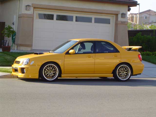

here you go. 18X8 48 offset with 225/40/18's. No rubbing, tires/rims will tuck into the fenderwell when lowered even more. I have a 2+ inch drop with my coilovers.

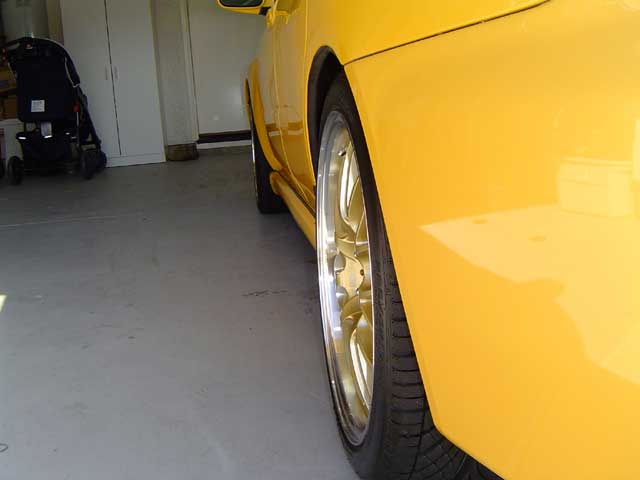

here's another side shot

damn that looks pimp. and thanks for the info. im glad to see that their is more than one person active in the forum. well off to make my car look as mean as yours.

version 1 replica front lip is fiberglass from ravspec.com. as well a s the grill (not fiberglass). Spoiler is stock with zerosport CF risers. Rims are formula mesh (volkner racing) 18X8 via importhookup.com
