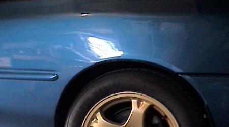

will 17's fit?

looks like it is lowered. the 215 will fit, the 245 will not, without some major fender rolling

205/55s are the safest bet. The 215 might still require a fender lip roll - though it will be close.

Originally posted by impreza2.5RS-1
well i'm ganna buy new tires soon and my dad wants me to get 17's so i will have a bit more clearance for my front bumper. Even though i'm in chicago, i go to wisconcin quite a bit so when i'm off road and its deep snow the 17's will help out more. Dexter, what is a fender dip roll? thanks for your help everybody
I think you've got the idea a little mixed up here. When you get larger diameter wheels, you have to get tires with a smaller sidewall in order to compensate. This is because the tire and wheel together must allways equal the same diameter in total in order to keep the clearance and gearing ratios.
ie if stock you had a 16 inch wheel and 5 inch sidewall 16+5 = 21 inches. So if you got a 17 inch wheel you'd have to get a 4 inch sidewall because you want to try and keep the total tire and wheel package at 21 inches. 18 inch wheel would be 3 inches and so on. (note that sidewalls are actually measured in a more complicated way, check out the sticky for more info on that).
And on snow tires you want MORE sidewall not less. so you should actually be getting a smaller wheel and a tire with more sidewall.

Hey if your dad says to get 17's, get 17's Best of luck! BTW, those 16's look like the JDM gold 16's -- where did you get them?
