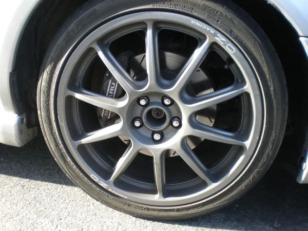

here's how mine turned out
Picture057.jpg?t=1288293047
Picture015.jpg?t=1288293080
