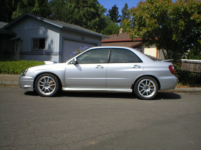

Im running 245/40/17 Khumo V700s on Rotoa 17X8 with no rubbing at all. 245/40/17s are the same diameter as 225/45/17s, 25" +/- a tenth depending on whose specs your reading, so they wont raise/lower your car or throw off your speedo. Also every 245/40/17 Ive ever seen is spec'd to fit on 8" wide rims. Check tire rack, they have specs for all the tires they sell.
here they are next to a 225
Attached Thumbnails what is the widest tire a 05 STI can accommodate?-p1010014.jpg

Question OT. what was involved to swap the rear wing?
I love my STI, but I'm kinda 50/50 in regards to the wing. It gives the car a killer look ( don't know if it really does anything though) and it blocks my rear vision of other cars, especially on the highway.
Your car looks great!, Is that with stock suspension? or did you drop it a tad?
Old Jul 8, 2004 | 09:35 PM
Krinkov's Avatar
yeah took the wing off the first week
And those are Tein springs, I like them because they even the wheel gap, most other springs drop but still leave uneven gap.
