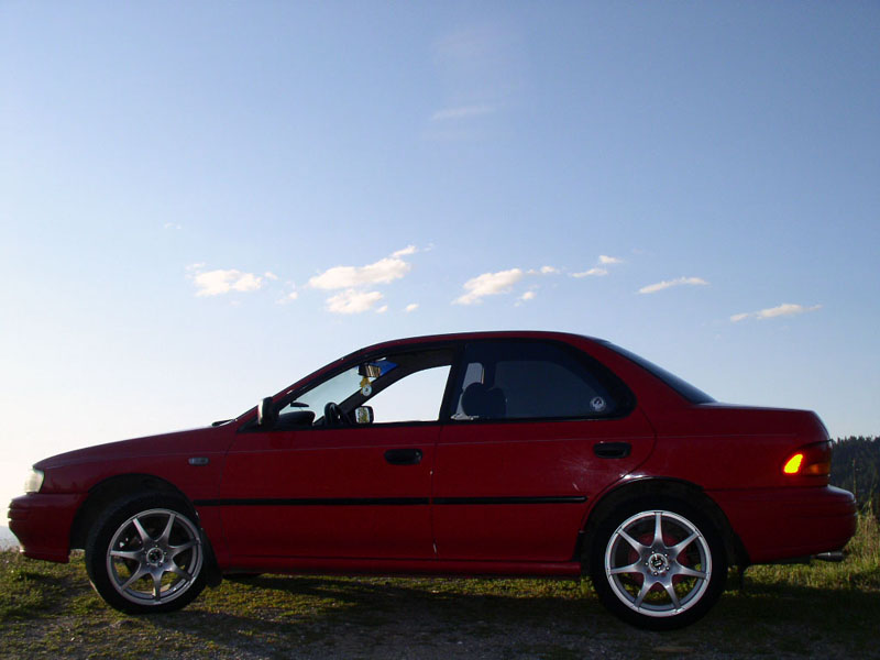

Well, I went to Schwabs and those stinkin' BBS wheels are $330 a piece (probably cause of the weight) so I am going with the ADR Type 2 Intense. It's a 7-spoke and they are going to swap me straight across even though I've been ridin' these wheels for about 2 months, only 3,000miles though. BTW anyone throw some KYB AGX's on a pre-97 impreza??? how do you like them? I am seriously ready to buy but wanna make sure they will be worth the money and I want to do the install myself, is it that hard???
Here they are.

Just an update. Here are the newest wheels.
