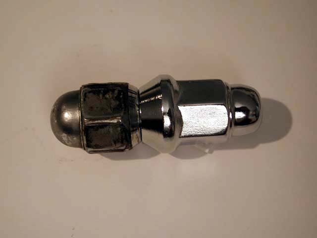

Here's the comparison of stock lugs vs the one use motegi and Rotas.
Now I know what is really the fitment problem
want more?
go to this link:http://www.subydude.com/mods/detailsdoc.php?3049

Thats a nice illustrative picture Thats kinda what I figured, but I suck at saying things
Anyway, glad to hear you got your answer. So is it all solved now? do you have your wheels and have them mounted?
